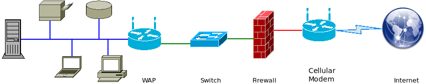

My understanding of your network is represented by the diagram below. Am I right?
If so, you can see three network segments in this diagram, represented by three colors: red, green, and blue. To help us determine how CacheGuard should be integrated into your network, please provide the following information for each network segment:
* Network address (e.g. 192.168.1.0)
* Netmask (e.g. 255.255.255.0 or /24)
* IP addresses of each network device

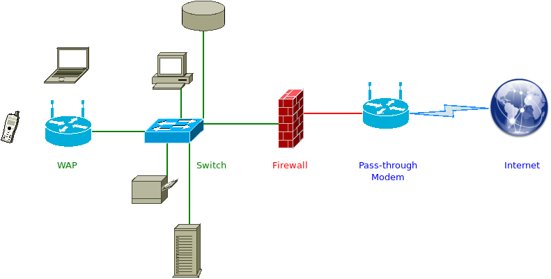

Charles, that is how my network is set up with the exception of after the switch. Everything with the exception of TV's, laptops and phones are ethernet connections.
My existing firewall is xx.xx.74.1
switch xx.xx.74.40
WAP xx.xx.74.32
David, the firewall/router is connected via Ethernet. I can't remember but I believe it is in pass-though mode to not do anything other than pass the connection to the firewall/router. In order to confirm it needs a hard reset to access the web UI.
Cachguard will replace the existing firewall/router. I would like to run a DNS server and a VPN in addition to firewall and routing.
Thank you

Thanks for this additional information.
Please find below an updated version of the diagram, revised to better represent your current setup.
If your ISP uses DHCP to provide your Internet connection, CacheGuard does not currently support obtaining a dynamic IP address from a DHCP server on its external interface. However, we can quickly implement DHCP client support on the external interface. DHCP support is already available when CacheGuard-OS is deployed on public clouds such as AWS and Azure, so extending this capability to on-premise deployments should be straightforward.
Most CacheGuard users are SMBs with business Internet connections that normally come with a router and/or a fixed public IP address. This is why DHCP and PPPoE connectivity on the external interface have not been a priority for us so far. However, your use case shows that this capability is important, and we will implement it in CacheGuard.
This would allow you to connect CacheGuard directly to your cellular modem in pass-through mode, without having to keep your existing firewall in front of CacheGuard.
The main limitation of using DHCP on the external interface is that some other features would become unavailable, such as High Availability through VRRP and multi-WAN support.
The approach you choose will help us determine the most appropriate final implementation for your particular setup. Just let us know which approach you would prefer, answer David's questions, and we will guide you from there.
