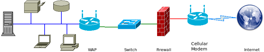

Re: Setup in a Home Network
My understanding of your network is represented by the diagram below. Am I right?
If so, you can see three network segments in this diagram, represented by three colors: red, green, and blue. To help us determine how CacheGuard should be integrated into your network, please provide the following information for each network segment:
* Network address (e.g. 192.168.1.0)
* Netmask (e.g. 255.255.255.0 or /24)
* IP addresses of each network device
Best regards,
Best regards,
