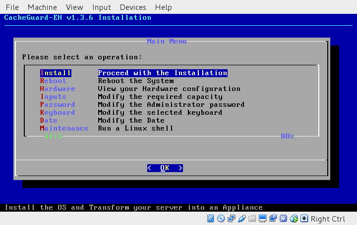

It would appear that the fdisk program can't create a partition during the installation. A possible reason might be the presence of another OS on your HDD. Also with a HDD larger that 2 TB it is likely that the cache partition exceed the upper limit of 2 TB.
Please select the Maintenance option in the installation main menu to run a Linux shell.
Then you can use the following Linux command to inspect your HDD partitions:
fdisk /dev/sda
If you are familiar with that Linux command you can try to delete all partitions and retry an installation. To return to the installation program use the following command:
exit
If the problem persists you can try one of the following methods (or a combination of all of them):

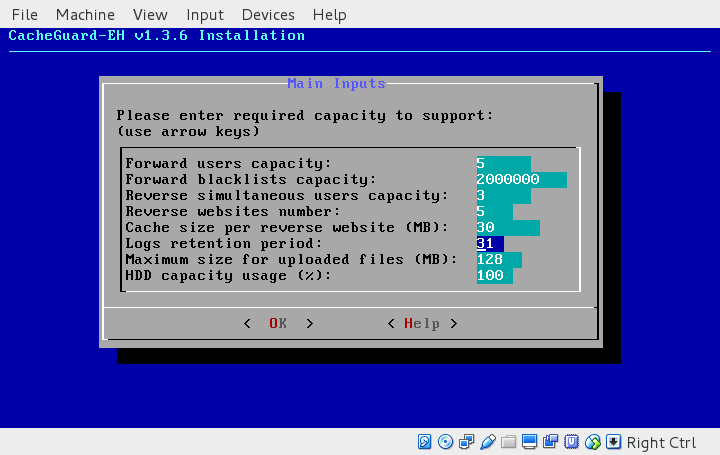

1- Increase your logs partitions by increasing your logs retention period (the maximum value is 31 days). In this way you will get a smaller partition for the Web cache (hopefully less than 2 TB). To set the logs retention period select the Inputs option in the installation main menu and hit enter until you reach the screen below and then enter 31 for the logs retention period.
2- Reduce your HDD capacity usage. For instance you can use 90 (for 90%) instead of 100. You can modify this value in the Main Inputs screen (see above).
3- Remove some HDD from your RAID group at the BIOS level to reduce your total HDD capacity. We normally recommend a 2 TB HDD for a 1250 users installation. For how many users are you installing CG?
4- Finally you can create two RAID groups of 1115.5 each (2231/2) so CG will detect two HDDs and share its Web cache between those 2 HDDs. Hence, you get around the 2 TB limit problem.
