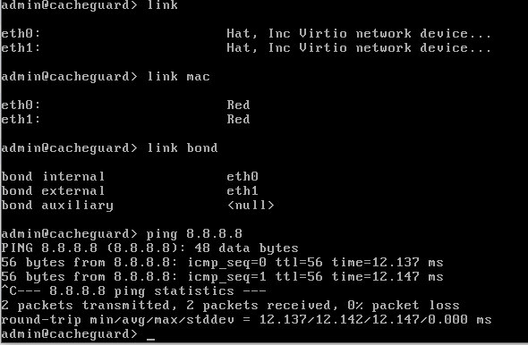

Attached file linkmac.PNG would have the output of the commands you are after.
To me it looks like the algorithm/regular expression you use to determine the mac from might in my case have picked up the "Red" from the "Red Hat"

Hum.. Yes you are right! Maybe this is specific to oVirt. I'll inform the development team and let you know when the bug fix is available.
