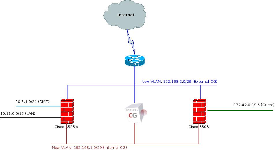

Also please note that you can route as many network as you want via CG but CG has a single internal network interface. Therefore the solution would be to create a new connectivity network shared between your two Cisco routers and the internal network interface of CG (a /29 is sufficient). In such an architecture the external network interface of CG can be directly connected to your DMZ. But to avoid any asymmetric routing a better solution would be to create a second connectivity network for the external network (shared between your two Cisco firewalls and the external network interface of CG). The rest is a matter of routing configuration.

Re: two internal networks and one external possible
Posted: 13 Feb 2017 21:52
by charles
Maybe the following network diagram could help to better understand the target architecture:
