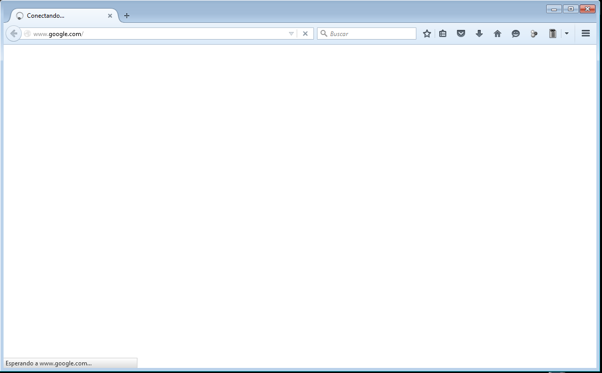

I have the following questions:
At times the proxy does not load a Web page or take long to solve.
But if the frame automatic configuration option (IE) my users navigate seamlessly.
a) As I can see the system log to know what is happening?
b) I can access Putty (ssh) to CacheGuard?
c) I have the version 1.1.2 and apply the patches?
Waiting for your help.

Re: Access and Supervision
Dear Jose
To answer you questions:
- You can use SSH (putty or any other SSH client) to remotely access to the CG CLI (Command Line Interface). But in order to have access via SSH you need to enable the ssh administration option using the following commands:
- You will also need to grant access to your remote administrator by adding his/her IP address to the list of allowed administrators. To do so please use the following commands:
- The Web page loading problem you encounter can't be resolved by upgrading to the latest version (which is NG v1.1.4 at the time of writing) as this version resolves other issues but not yours. I rather think that your issue may come from an IP misconfiguration or an issue related to CG cabling. I suggest that you check the following:
After having performed those commands you can have access to the Web Audit page at https://<your-ineternal-cg-ip-address>:8091 (8091 is the default port). In your case it should be https://192.168.15.12:8091.
