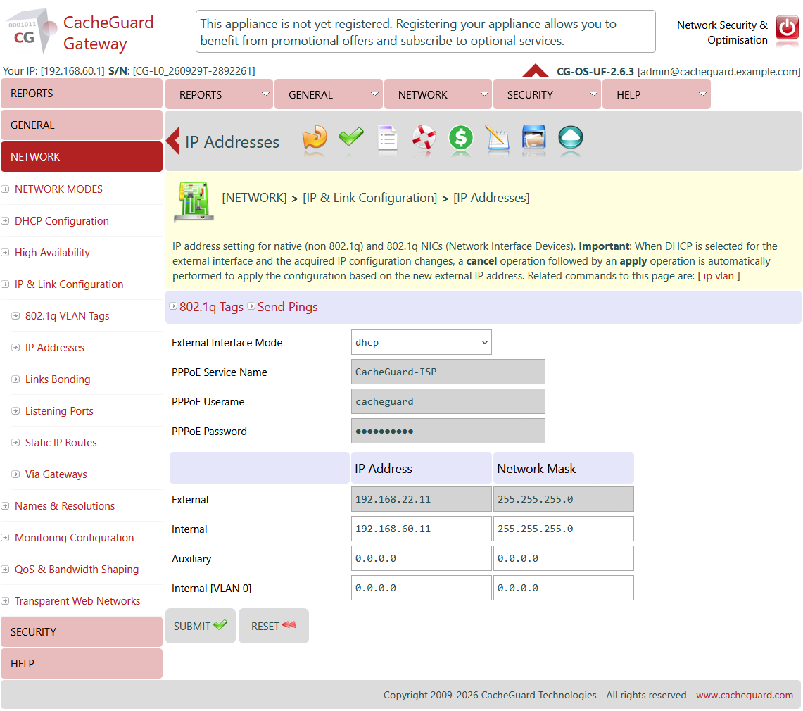

We have just released CacheGuard-UF-2.6.2, which includes several improvements to external network (WAN) connectivity.
The new release now supports both PPPoE and DHCP on the external interface. This can be particularly useful for users whose ISP does not provide a router or Internet box, as CacheGuard can connect directly to the ISP connection and obtain its external IP configuration automatically.
All CacheGuard features that depend on the external IP address have also been reviewed so that they are automatically reconfigured whenever the external IP address changes. This makes it much easier to use CacheGuard with ISPs that provide dynamic WAN addressing, without requiring manual reconfiguration whenever the external IP address changes.
The external interface can be configured either via the CLI using the ip command or via the Web Administration GUI at [NETWORK] > [IP & Link Configuration] > [IP Addresses].
Below is a screenshot of this page.
The complete release notes for CacheGuard-UF-2.6.2 are available here:
https://github.com/cacheguard/CacheGuard-OS/releases/tag/v2.6.2
The upgrade can be performed automatically from the Web Administration GUI via [GENERAL] > [System Operations] > [Load OS Patch].
