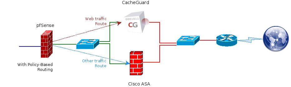

If I understand this correctly the internal IP of your CG should be 192.168.254.21 and its external IP 192.168.253.21. Also my understanding is that your CG is implemented in parallel with your (Cisco ASA Routing / FW) at the DC end. Therefore CG as an explicit proxy is reached at 192.168.254.21:8080 from machines located on your Workstation VLAN (192.168.0.0/2). Can you confirm my understanding please?
Let's say YES to my question above. By simplifying, your network architecture should be similar to the diagram below.
To accomplish what you need you can't use a [Firewall /NAT / PortForward] rule on a pfSense. Actually if the pfSense is configured to froward the HTTP port to the internal interface of CG (192.168.254.21 in your case), you tell to CG that you want to address CG itself on its HTTP port. In this case you will get the content of http://192.168.254.21:80 (which contains some information about your CG) and not the content of the initial destination address (which could be http://www.cacheguard.net for instance). But you don't want that. Right? What you really need is to:
- Route all HTTP traffic via the internal interface of your CG (192.168.254.21) letting unchanged the destination address of HTTP traffic AND
- Let other traffic being routed via your Cisco ASA Routing/FW at the DC end.
To do so you will need to configure a policy routing rule on your pfSense that route HTTP traffic via your CG. I'm not a pfSense expert but after having taken a quick look at the WebGUI of my pfSense I think that you should do the following:
- Create a new gateway for your CG (System / Routing / Gateways).
- Define a firewall rule that uses CG as a gateway for HTTP traffic (Firewall / Rules / LAN, Advanced Options).
Please let me know if by doing so this works.
Kind Regards,

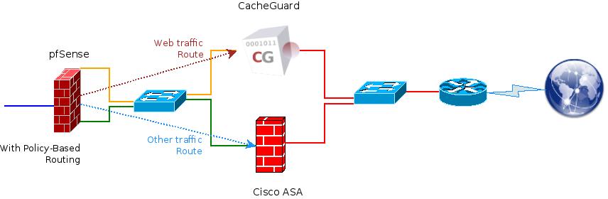

We just finished to test the proposed architecture in our lab using a pfSense 2.3.4-RELEASE. We have found that pfSense policy routing does not work if both gateways (CG and ASA) are in the same VLAN. This is either a pfSense bug or a feature. Therefore we created a dedicated connectivity VLAN (in orange) between our CG and pfSense and it finally worked. Below the modified architecture diagram.
We therefore recommend to do the following:
- Use policy routing (and not port forwarding)
- Create a distinct VLAN between your pfSense and CG (here in orange)
I hope that you can create multiple VLANS/Subnets on your PTP Fibre to DC Inter LAN Switchs. Please let us know if our solutions works in your environment.
